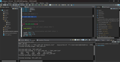

STM32CubeMX always generates the function MX_LWIP_Init even when its generation is disabled. This causes a redefinition during compilation if a custom implementation already exists. On every regeneration the autogenerated file re inserts the function and its prototype, triggering the conflict.

Further to the Screen Recording, I noticed that you added code line between
/* USER CODE BEGIN 2 */
/* USER CODE END 2 */
And after the generation, the part line placed between the /* USER CODE BEGIN */ and /* USER CODE END */ is not being deleted.

In my case, I’m placing my own initialization code in the only appropriate place available — between the /* USER CODE BEGIN */ and /* USER CODE END */ blocks. Based on all this, I still believe this is a bug.
I'd really appreciate it if you could try placing your own initialization function between the USER CODE blocks and let me know if it fails to compile due to a duplicate definition. If that’s the case, how are we supposed to add custom initialization code if CubeMX doesn't properly respect the option to not generate it?
