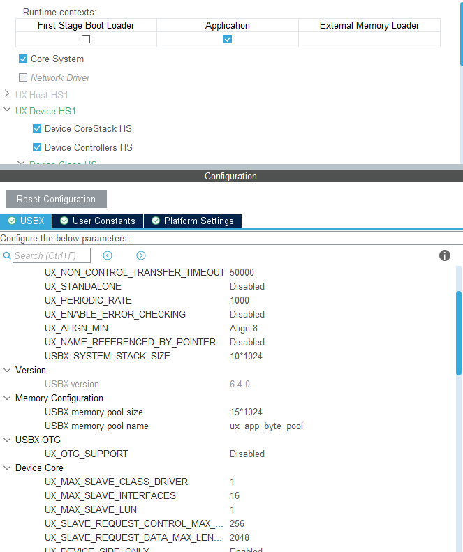

I'm trying to implement USB communication with a PC using USB1 (USB-C port) on an STM32N6570-DK with CubeMX. Most tutorials I've found on USBX are for older CubeMX versions and boards, so I'm a bit stuck.
When I connect the board to my PC, I only get Error Code 43 in Device Manager. Here's what I've done so far:
Enabled PA4 as shown in this diagram:

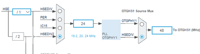

Changed clock configuration to 48 MHz.:

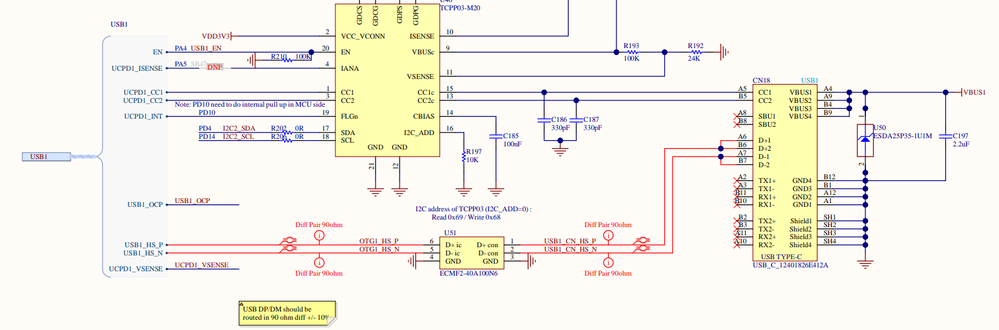

2025-09-14 7:20 PM
The status in Device Manager says "Device descriptor request failed".
VID 0000 and PID 0002 are not related to your device descriptors, this just means that the host cannot read the descriptors. A hardware USB sniffer would be helpful to understand why.
2025-09-14 7:59 PM
Incomplete configuration.

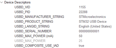

2025-09-15 5:47 PM
@Pavel A. I understand that. By default generated descriptor configuration should be good.
@zenderliving497 What am I missing then? I thought it should be enough to read descriptor by pc.
2025-09-15 5:59 PM
Assuming the descriptors in the code are good, the problem is that the device fails to move the bits over the wires. This happens. Get a real USB bus analyzer and look what is going there. (not a software one such as wireshark). Warning: this kind of lab equipment is rare these days and can be expensive.
2025-10-10 3:38 AM
Hi @TerZer
It seems the issue is coming from CubeMX code generation! Check the example provided here to check the initialization. If still having issues to enumerate as CDC, provide your source code to help you further.
2025-10-10 4:34 AM
My solution was to change HAL_PCD_MspInit in stm32n6xx_hal_msp.c file to this:
* @brief PCD MSP Initialization
* This function configures the hardware resources used in this example
* @PAram hpcd: PCD handle pointer
* @retval None
void HAL_PCD_MspInit(PCD_HandleTypeDef* hpcd)
RCC_PeriphCLKInitTypeDef PeriphClkInitStruct = {0};
if(hpcd->Instance==USB1_OTG_HS)
/* USER CODE BEGIN USB1_OTG_HS_MspInit 0 */
__HAL_RCC_PWR_CLK_ENABLE();
/** Set USB OTG HS PHY1 Reference Clock Source */
PeriphClkInitStruct.PeriphClockSelection = RCC_PERIPHCLK_USBPHY1;
PeriphClkInitStruct.UsbPhy1ClockSelection = RCC_USBPHY1REFCLKSOURCE_HSE_DIRECT;
if (HAL_RCCEx_PeriphCLKConfig(&PeriphClkInitStruct) != HAL_OK)
/* Initialization Error */
Error_Handler();
/* USER CODE END USB1_OTG_HS_MspInit 0 */
/** Initializes the peripherals clock
PeriphClkInitStruct.PeriphClockSelection = RCC_PERIPHCLK_USBOTGHS1;
PeriphClkInitStruct.UsbOtgHs1ClockSelection = RCC_USBPHY1REFCLKSOURCE_HSE_DIRECT;
Error_Handler();
/* Enable VDDUSB */
HAL_PWREx_EnableVddUSB();
/* Peripheral clock enable */
__HAL_RCC_USB1_OTG_HS_CLK_ENABLE();
__HAL_RCC_USB1_OTG_HS_PHY_CLK_ENABLE();
/* USB1_OTG_HS interrupt Init */
HAL_NVIC_SetPriority(USB1_OTG_HS_IRQn, 2, 0);
HAL_NVIC_EnableIRQ(USB1_OTG_HS_IRQn);
/* USER CODE BEGIN USB1_OTG_HS_MspInit 1 */
__HAL_RCC_GPIOA_CLK_ENABLE();
LL_AHB5_GRP1_ForceReset(0x00800000);
__HAL_RCC_USB1_OTG_HS_FORCE_RESET();
__HAL_RCC_USB1_OTG_HS_PHY_FORCE_RESET();
LL_RCC_HSE_SelectHSEDiv2AsDiv2Clock();
LL_AHB5_GRP1_ReleaseReset(0x00800000);
/* Required few clock cycles before accessing USB PHY Controller Registers */
HAL_Delay(1);
USB1_HS_PHYC->USBPHYC_CR &= ~(0x7 << 0x4);
USB1_HS_PHYC->USBPHYC_CR |= (0x1 << 16) |
(0x2 << 4) |
(0x1 << 2) |
0x1U;
__HAL_RCC_USB1_OTG_HS_PHY_RELEASE_RESET();
/* Required few clock cycles before Releasing Reset */
HAL_Delay(1);
__HAL_RCC_USB1_OTG_HS_RELEASE_RESET();
/* Peripheral PHY clock enable */
/* USER CODE END USB1_OTG_HS_MspInit 1 */
}Also to enable bulk communication don't forget to add this bit in MX_USBX_Device_Stack_Init code:
