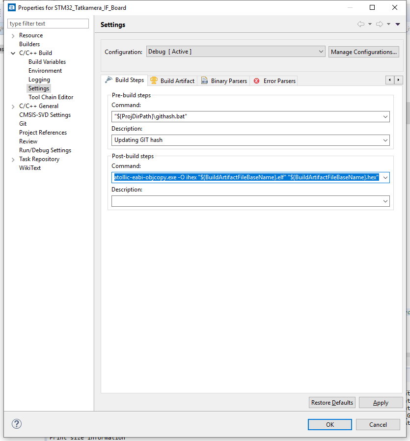

2019-04-26 3:14 AM
It works but it kills any custom settings made in the Post-Build steps. as I use this to calculate a checksum and make a flashable Image for the target here, I consider this still as a bug and highly annoying.
CubeMX shall not touch this line when generating / regenerating code.
