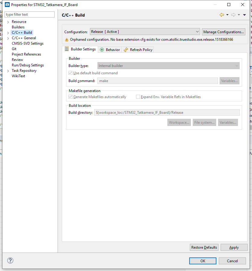

If you generate a project for Atollic and try to use it's Release build configuration, Atollic will show a warning in project settings:
"Orphaned configuration. No base extension cfg exists for com.atollic.truestudio.exe.release.1518366166"
You can reproduce this with a clear project, it happens every time. I'm working with STM MCU's for a year, and inbuilt Release configuration always showing this error.

On top it overwrites my custom "post build" settings which I use to generate a flash file including a CRC32 automatically after the build. This is in .cproject
