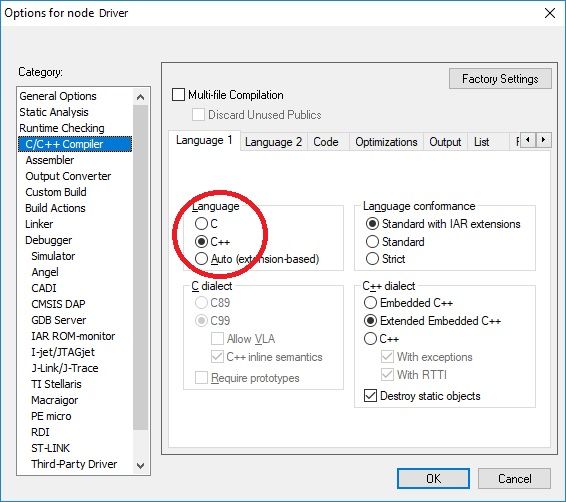

Hi Sirma,
This issue occured only with the C++ compiler. I suppose you've compiled your project with C compiler.
The '' ♯ defined __cplusplus integer'' is defined only in C++ compilers. Its value activate or not the directive '' ♯ extern C'' which have an effect on linkage and name-mangling of wrapped declarations.
As it's done in i2c.h (and may be in other peripherical interfaces), the declaration of extern void __Error_Handler(char *, int);
must be declared as ♯ extern ''C'' also in main.h.
I attached a picture showing my compiler options.
Thx and Regards
Nig
