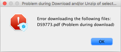

STM32CubeMX fails to download documents with the following error:
In STM32CubeMX.log (for more details please find attached
STM32CubeMX.log
2018-06-24 10:50:07,628 [ERROR] ServerAccessManage:989 - Problem during Server Connexion : IO error Remote host terminated the handshake
2018-06-24 10:50:07,628 [ERROR] ServerAccessManage:487 - Problem during Server Connexion : : DS9773.pdf.~~~
##stm32cubemxSolved! Go to Solution.

Hi Albert,
We just changed CubeMX servers and we are sorry for the errors you got.
Please retry again and if the issue persists remove .stm32cubemx and .stmcufinder folders under your user (login) folder
