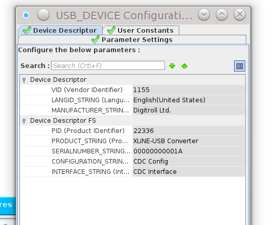

If I setup custom string USB string descriptors in the CDC Middleware configuration...
..these strings will be generated to the usbd_desc.c file in the following format:

When compiling this code with gcc I got the following warnings:
pointer targets in passing argument 1 of 'USBD_GetString' differ in signedness [-Wpointer-sign] usbd_desc.c /xlineusb/Src line 76 C/C++ Problem�?
It is because the the USBD_getString expects unsigned pointer:
void USBD_GetString (uint8_t *desc, uint8_t *unicode, uint16_t *len);�?
I would recommend to generate the USB descriptor strings in the following format to prevent these warnings:
