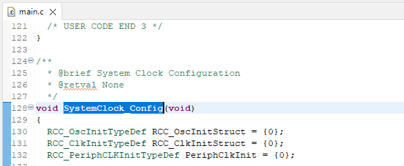

2025-01-27 1:07 AM
@lgacnik97 wrote:the SystemClock_Config() is always static within the main.c where this function is also generated. !
I see it in main.c, but it's not static:
But is it also not prototyped in any generated header - which does seem inconsistent.
