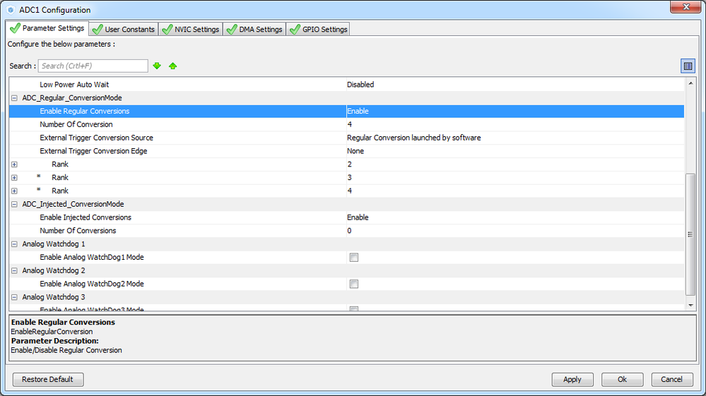

I don't know what i did... but my Rank1 is gone in ADC 1 & 2 ??
I have 4 input i want to sample...
If i configure a new project.. i get all 4, but not in this one :-S
Clues or bug ??

I solved it by disabling the regular Conversions.. and then enable it again.. then Rank 1 appeared correct.
Will try to se hvad i did to provoke the error..
I have attached the config./M

Hello, I had the same problem (I spend a few days before seeing this issue)...
I started to configure the ADC1 with one channel (in DMA mode) it was ok, then I tried to have two channels (Channel 0 and temperature sensor, then I was not enable to configure RANK_1 and I did not understand how to find the channel_0 conversion in my DMA Buffer.
to solve the problem, I invalidate all the channels save project and validate the two channels, now I have the 2 rank to configure... :thumbs_up:

Just add the same bug (jan 2022)
It's not just a visual bug, as it affects the code generation as well.
Unselecting all the ADC channels and starting again solved the problem.
