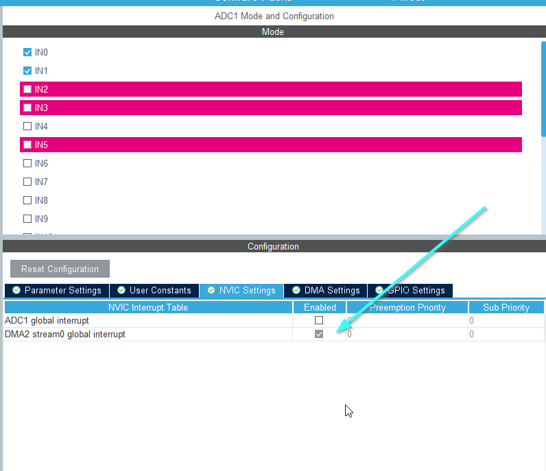

For some reason, CubeMX won't let me disable the DMA IRQ in the ADC configuration panel.
The ability to deactivate ISR is important when the ADC is configured in continuous mode.
Because my ADC conversion is small, the ISR are generated at a very high frequency; completely choking the CPU.
How do you disable ADC DMA interrupts in cubeMX?

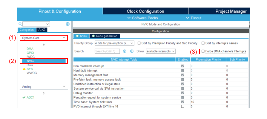

There is an option in System Core - NVIC called Force DMA channels Interrupts. Please unchecked this option and you can now disable DMA interrupt from NVIC settings in ADC1 menu or directly in NVIC menu.

2022-02-02 6:10 AM
Dear Gabriel,
Best regards,
Gwénolé
2022-02-02 6:47 AM
Dear Gwénolé,
Thanks for your help.
This is exactly what I needed.
I'm not sure why this would be set by default ¯\_(ツ)_/¯
Thanks again.
