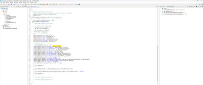

Example 1 — Request = Software:
static void MX_GPDMA1_Init(void)
/* USER CODE BEGIN GPDMA1_Init 0 */
/* USER CODE END GPDMA1_Init 0 */
DMA_NodeConfTypeDef NodeConfig = {0};
/* Peripheral clock enable */
__HAL_RCC_GPDMA1_CLK_ENABLE();
/* GPDMA1 interrupt Init */
HAL_NVIC_SetPriority(GPDMA1_Channel0_IRQn, 0, 0);
HAL_NVIC_EnableIRQ(GPDMA1_Channel0_IRQn);
/* USER CODE BEGIN GPDMA1_Init 1 */
/* USER CODE END GPDMA1_Init 1 */
NodeConfig.NodeType = DMA_GPDMA_LINEAR_NODE;
NodeConfig.Init.Request = DMA_REQUEST_SW;
NodeConfig.Init.BlkHWRequest = DMA_BREQ_SINGLE_BURST;
NodeConfig.Init.Direction = DMA_MEMORY_TO_MEMORY;
NodeConfig.Init.SrcInc = DMA_SINC_FIXED;
NodeConfig.Init.DestInc = DMA_DINC_FIXED;
NodeConfig.Init.SrcDataWidth = DMA_SRC_DATAWIDTH_BYTE;
NodeConfig.Init.DestDataWidth = DMA_DEST_DATAWIDTH_BYTE;
NodeConfig.Init.SrcBurstLength = 1;
NodeConfig.Init.DestBurstLength = 1;
NodeConfig.Init.TransferAllocatedPort = DMA_SRC_ALLOCATED_PORT0|DMA_DEST_ALLOCATED_PORT0;
NodeConfig.Init.TransferEventMode = DMA_TCEM_BLOCK_TRANSFER;
NodeConfig.Init.Mode = DMA_NORMAL;
NodeConfig.TriggerConfig.TriggerPolarity = DMA_TRIG_POLARITY_MASKED;
NodeConfig.DataHandlingConfig.DataExchange = DMA_EXCHANGE_NONE;
NodeConfig.DataHandlingConfig.DataAlignment = DMA_DATA_RIGHTALIGN_ZEROPADDED;
NodeConfig.SrcAddress = 0;
NodeConfig.DstAddress = 0;
NodeConfig.DataSize = 0;
if (HAL_DMAEx_List_BuildNode(&NodeConfig, &Node_GPDMA1_Channel0) != HAL_OK)
Error_Handler();
if (HAL_DMAEx_List_InsertNode(&List_GPDMA1_Channel0, NULL, &Node_GPDMA1_Channel0) != HAL_OK)
Error_Handler();
if (HAL_DMAEx_List_SetCircularMode(&List_GPDMA1_Channel0) != HAL_OK)
Error_Handler();
handle_GPDMA1_Channel0.Instance = GPDMA1_Channel0;
handle_GPDMA1_Channel0.InitLinkedList.Priority = DMA_LOW_PRIORITY_LOW_WEIGHT;
handle_GPDMA1_Channel0.InitLinkedList.LinkStepMode = DMA_LSM_FULL_EXECUTION;
handle_GPDMA1_Channel0.InitLinkedList.LinkAllocatedPort = DMA_LINK_ALLOCATED_PORT1;
handle_GPDMA1_Channel0.InitLinkedList.TransferEventMode = DMA_TCEM_BLOCK_TRANSFER;
handle_GPDMA1_Channel0.InitLinkedList.LinkedListMode = DMA_LINKEDLIST_CIRCULAR;
if (HAL_DMAEx_List_Init(&handle_GPDMA1_Channel0) != HAL_OK)
Error_Handler();
if (HAL_DMAEx_List_LinkQ(&handle_GPDMA1_Channel0, &List_GPDMA1_Channel0) != HAL_OK)
Error_Handler();
if (HAL_DMA_ConfigChannelAttributes(&handle_GPDMA1_Channel0, DMA_CHANNEL_NPRIV) != HAL_OK)
Error_Handler();
/* USER CODE BEGIN GPDMA1_Init 2 */
/* USER CODE END GPDMA1_Init 2 */
