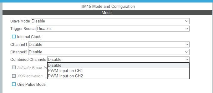

In TIM15 -> Mode -> Combined Channels it is not possible to select XOR input on TI1:

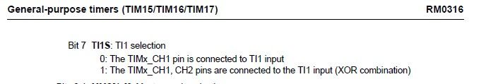

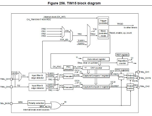

In the reference manual (RM0316) at page 685 you can see the XOR input:
And at page 720, the register TIM15_CR2[TI1S] description:
So I suppose that there really is the possibility of activating the XOR input for TI1 of TIM15, but the possibility of doing it in STM32CubeMX is missing. Maybe a BUG?

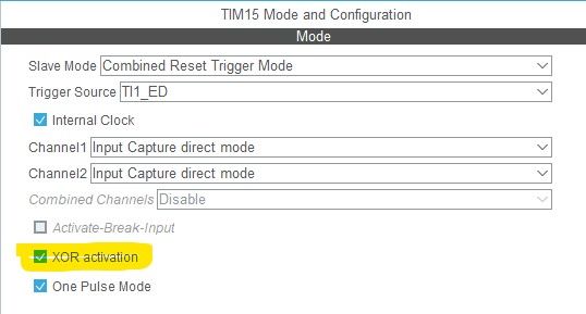

2019-02-08 2:26 AM
Sorry, I'm really stupid! I did not realize that there is a flag to be activated to enable the XOR function:
I thought that the XOR setting for TIM15 was identical to those of the other timer, but I was wrong.
Andrea.

2019-02-08 2:26 AM
Andrea.
