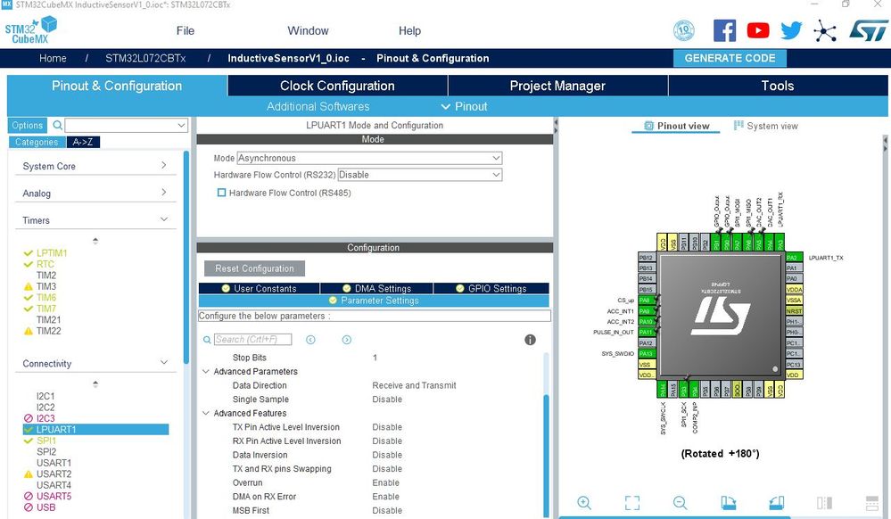

I migrate my CubeMx project that is based on stm32l072cbtx to version 5.0.1 but in connectivity menu, LPUART1 NVIC settings doesn't appear. So I can't enable LPUART1 interrupts with code generation. Is there any problem? or I've missed something

You are right, i was able to reproduce the issue and it will be fixed in the next STM32CubeMX release.

I have updated the CubeMX to the latest version (v 5.1.0) and the issue is still there. I cannot enable the LPUART interrupt.
Any ideas?

Hi @anio1491
Thanks for the feedback.
It will be available soon.
