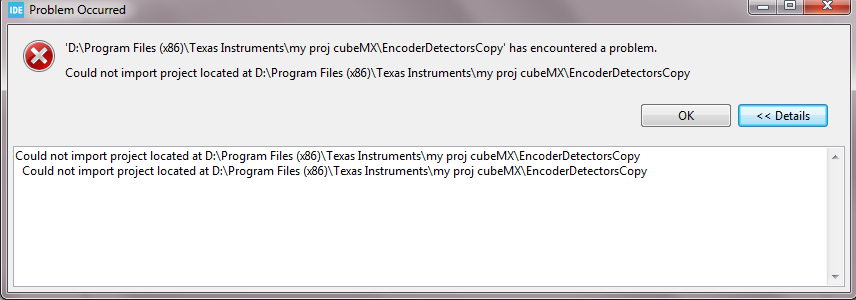

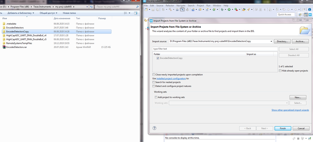

But this is another surprice! I can't import copy of my prev project. I copy-past folder, rename it and try to import... You say that path is too long, but I can import all projects from "D:\Program Files (x86)\Texas Instruments\my proj cubeMX" except "EncoderDetectorsCopy" even if I rename it to "lala". But if I cut "EncoderDetectorsCopy" to "D:", I can import it, cut again to "D:\Program Files (x86)\Texas Instruments\my proj cubeMX" and import to CubeIDE normally! Windows 7, CubeIDE 1.41 Build: 7610_20200730_1509
