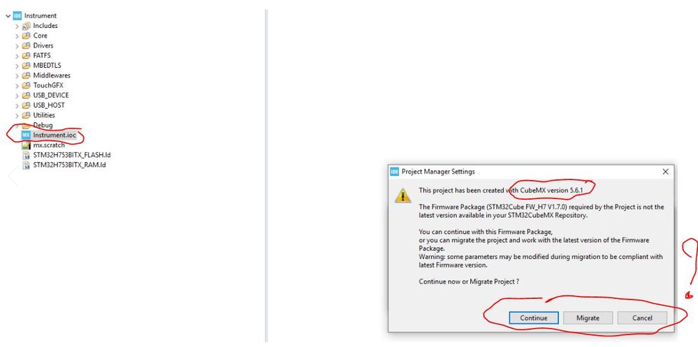

I am trying to use STM32CubeIDE 1.4.0. Previously I was using 1.3.0. I was calling the CubeMX, since I wanted to make a change to the configuration. When CubeMX generated the update code, it deleted the entire project. No traces of the project are left, except for the root directory and and an empty directory "Drivers/CMSIS". Why is this happening? Forunately, I made a backup just before I did this, otherwise my entire project would have been gone.

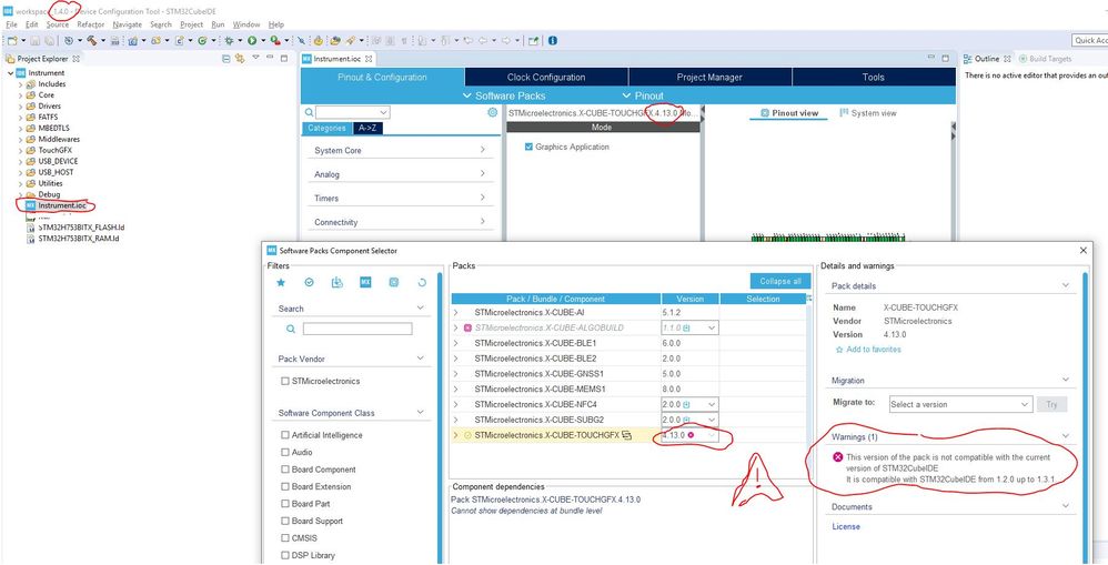

Moving then to 1.4.0 and asking for project update from device configuration tool is performing almost full project removal :o :sad_but_relieved_face:

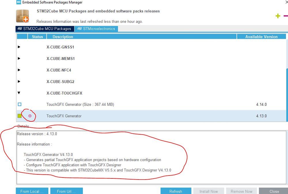

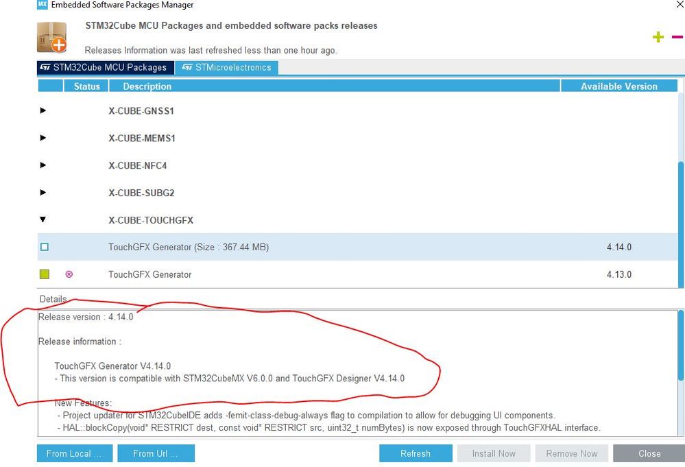

Not mastering such enough but sounds related to the fact your're using TouchGFX pack. Device configuration tool is claiming 4.13 is not supported. have to migrate to 4.14 ....
I've not tried but maybe taking care of some migration option is doing proper job ? @Martin KJELDSEN @Alexandre RENOUX @Romain DIELEMAN TouchGFX experts please help here !

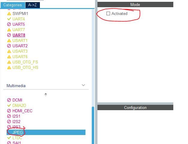

Let's try to disable JPEG multimedia and you are saving your project.
I agree such is not a solution anyway ...
Doing such is disabling 'Utilities' folder usage which sounds be root issue source
