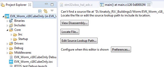

[Bug]
I have got problem with CubeIDE 1.41 on Windows. CubeIDE sometimes delete \Core\Src folder of projects. I often delete projects from IDE but never check Delete project content on disk. After deleting I am copy project with new folder name, open it on IDE and rename. This is my simplest control version system. The joke is that I can build and debug project without \Core\Src. Before project Clear of cause...
Also there is problem with slash direction. I usually use CubeIDE on Ubuntu, but sometime on Windows.

2020-08-05 12:11 AM
Loosing Core/Src are you doing any code generation from .ioc editor (aka. device configuration tool) ? Or "only" project copy / paste move / rename /close / open action(s) ?
2020-08-05 8:55 AM
"only" project copy / paste move / rename /close / open action(s) .
