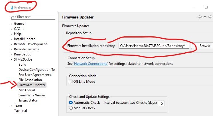

Maybe such is helping you:
This way you can set your own global local repo if FW packs. But I would recommend to point on expected FW pack release.
You have many ways thru file system to force version you want but part of your own risk then. It may perfectly work or not ... depends on IPs you're relying on etc etc ...

2022-04-28 2:17 AM
True STM32CubeIDE is claiming STM32CubeMX integration and myself I consider such is validated. But integration does not mean 100% match some features or options from time to time are lacking relying on good reasons I guess ... I may agree an IDE context is not same that a point tool one.
2022-04-28 2:20 AM
That a valid workaround, thanks
