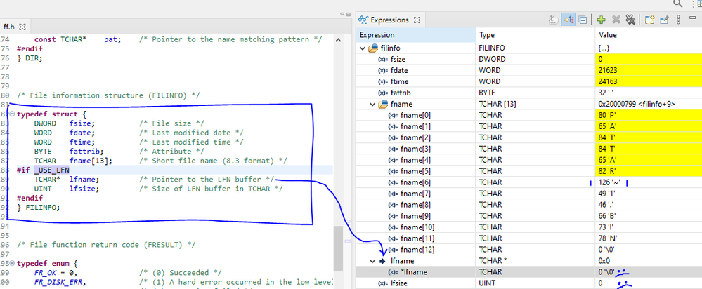

I am able to read the fixed length fname.
But the pointer to the long filename is always 0.

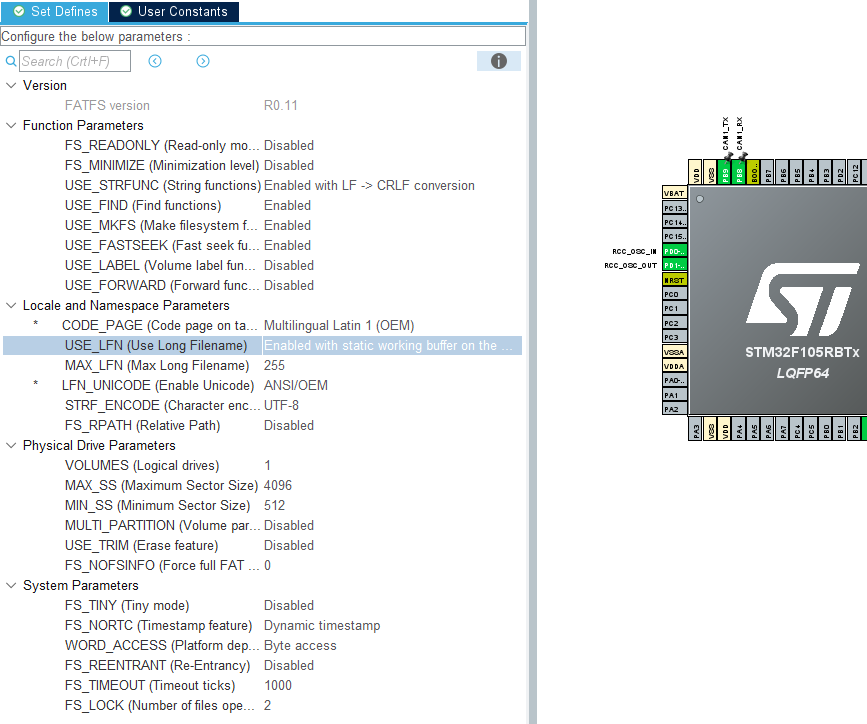

}I tried the three different cubeMx options for long filenames :
None of them works.

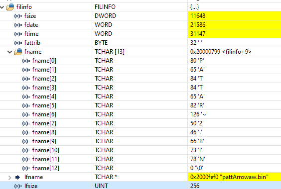

2022-04-28 5:09 AM

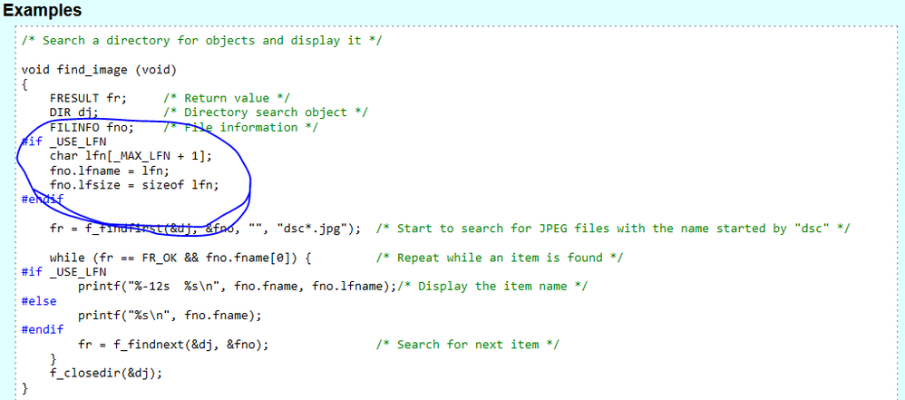

Okay that wasnt so hard, i just needed to find up to date documentation.
(C:\Users\**your user**\STM32Cube\Repository\STM32Cube_FW_F1_V1.8.4\Middlewares\Third_Party\FatFs\doc)
Apparently the pointer needs to be initialiced by you first.
adding this three lines fixes the code:
