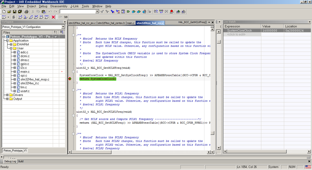

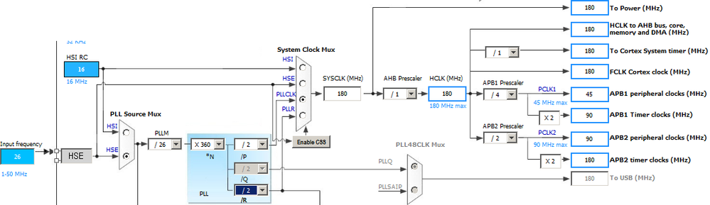

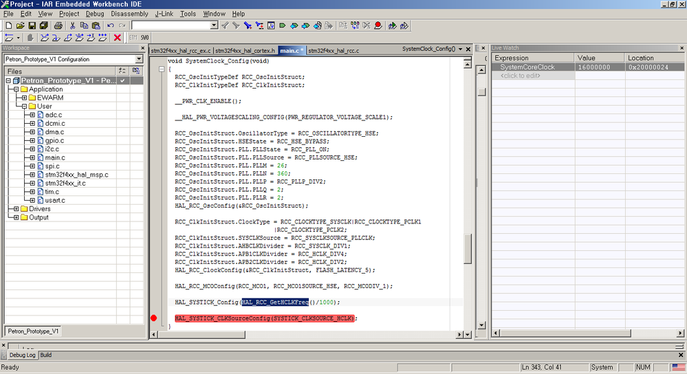

(\STM32Cube_FW_F4_V1.6.0\Drivers\STM32F4xx_HAL_Driver\Release_Notes.html) Moreover, the description of the library's source code show the version at the top. 2. I got the version difference of between the CubeMX library and Standard Peripheral library. 3. The clock configuration bug. 26MHz HSE but the HAL_RCC_GetHCLKFreq() in the SystemClock_Config() does not display the 180MHz. The SystemClock_Config() function in the main() should configure correctly. However, the watch result is wrong. (The other hands, the result of using Standard library shows 180MHz)2015-06-25 10:18 PM
Obviously, this is the bug of STM32CubeMX clock generation.
I upload the 2 files. - the original generated system_stm32f4xx.c file - the modifiedsystem_stm32f4xx.c file There are no clock setting code in the SysInit() function. SetSysClock() function is omitted in the generated code. ________________ Attachments : system_stm32f4xx_modified.c : https://st--c.eu10.content.force.com/sfc/dist/version/download/?oid=00Db0000000YtG6&ids=0680X000006HzSV&d=%2Fa%2F0X0000000bM6%2F_puwMpPY.Ai3LO25.9ZbzGoek15zTxPaCazkb899vcE&asPdf=falsesystem_stm32f4xx_original.c : https://st--c.eu10.content.force.com/sfc/dist/version/download/?oid=00Db0000000YtG6&ids=0680X000006HzSQ&d=%2Fa%2F0X0000000bM7%2F9vX6c9Qk8WI.43DtWykIbDCgpO4F5TbPrHWHtjm6fJA&asPdf=falseWe’re moving the ST Community to a new platform to give you a better and more reliable community experience.
