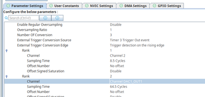

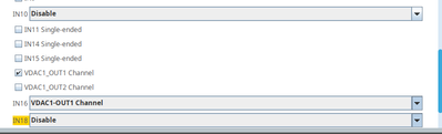

You have to use/set an input of the ADC also to the internal dac: int16 here
...then can use it:
so the "bug-report" ....is for ? :)
