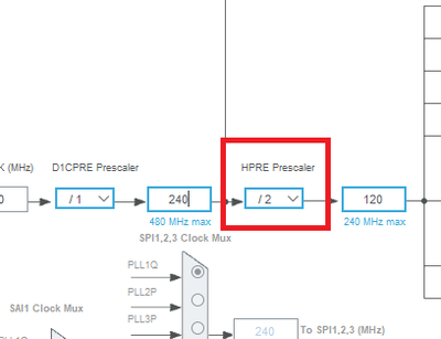

Getting back to you regarding CubeMx. There is an issue in CubeMx V6.12.1.
For System clock @240MHz/VOS2, the HPRE prescaler needs to be 2.
So in your ioc file set HPRE to 2 instead of 1.
