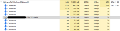

- CubeMX is loading my system (come one... look at my PC properties)

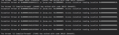

When I try to debug
I am getting this exceptions
It can be show something about the problem what you wrote to me.
It is possible to dig and debug, but someone should do this, right? If your IT allows, reformat the PC, reinstall clean Windows and everything should work.

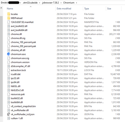

Avoid unsupported or 3rd party applications, use standard and supported stuff. For example: Chromium is bad (do you know why it is installed?) Official Google Chrome is good. Edge is good.
I think you are right. I should to reinstall the Windows... I don't see another way now.
But I don't know what is Chromium, how I got it... usually I don't install something that is not trusted or is unverified. It installed with IDE how I can see... because I reinstalled IDE and CubeMX and deleted all files before in folder user too. Look now:
I downloaded all thing from ST.com
Sorry my bad about Chromuim. Yes it looks like the infamous ST logon stuff. Nothing to do about it.
