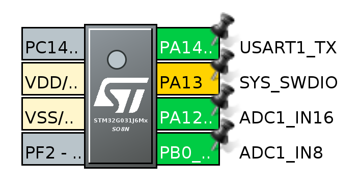

STM32G031C6 has no SO8N in CubeMX.

In CubeMX I'm working with STM32G031J6Mx SO8N. I think that both chips are mostly the same.
2023-02-16 3:17 AM
Yeah, the disco board? For your above plots: double-check that you have probed the correct pins. On my disco, I have swapped RX and TX pins internally (CubeMX), so PB6 is free for SWD debugging. Make sure that TX is configured as push-pull PP, not OD by CubeMX.
Its also advisable to leave/config PF2 as NRST (option bytes), so you don't lock out yourself like several people here already did.
[Edit]: Have tried it with HAL_UART_Transmit_DMA and .. it worked as expected.
