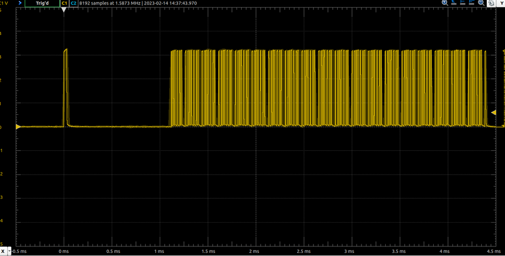

I'm trying to setup an USART for a very small MCU of the STM32G0 family, the MCU it's theoretically being programmed, but the USART is not responding, I configured the MCU just like I did in other projects (of bigger MCUs), I'm not able to find what I'm doing wrong in this case.
This is what I can see from the USART (theoretically in this image I'm sending "0xFF" all the time, but it does the same whatever I put in the buffer).

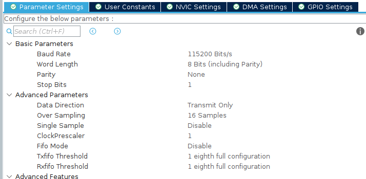

The USART is configured as Half-duplex (as it need to be) & baudrate, word length, etc...are correct:

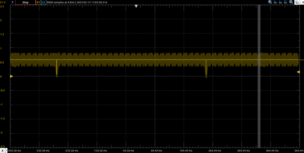

2023-02-13 3:19 AM
EDIT: If I remove the watchdog the "spikes" that go to 0 disapear.

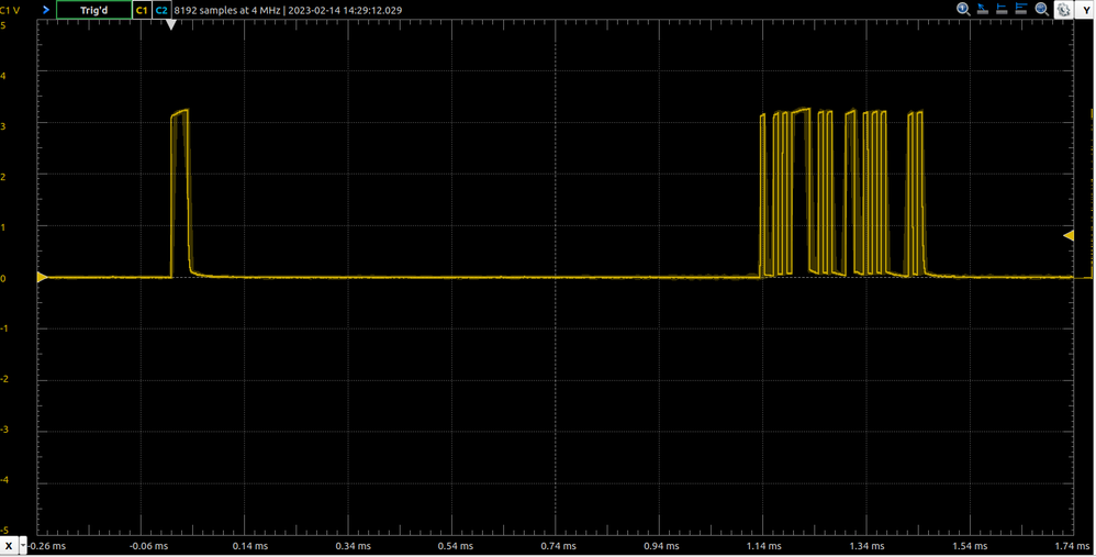

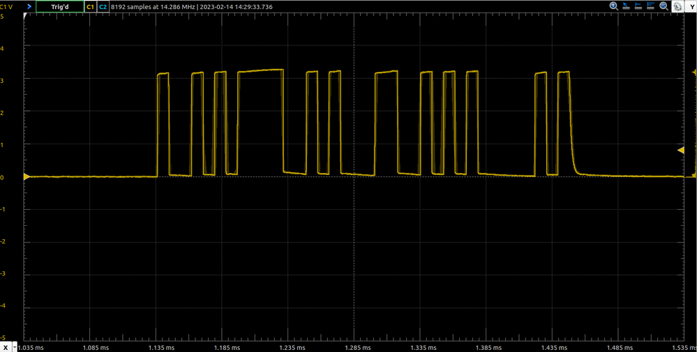

2023-02-14 5:30 AM
Just as a reference, this is what I've got now, it should be saying "HOLA" using the UART with an DMA, I'm receiving other stuff mostly random symbols, I can't seem to find the relation to it:

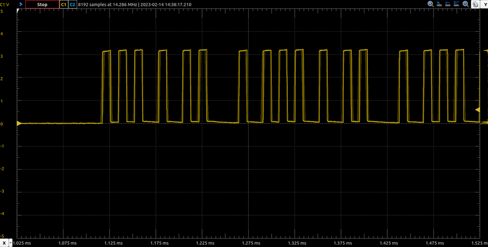

2023-02-14 5:38 AM
Now I've tried to write "*\n* just to have some other signal to compare like the one in this link: https://hackaday.com/2016/06/22/what-could-go-wrong-asynchronous-serial-edition/
It seems that in my case the message keeps repeating multiple times. But the bits are correct:
2023-02-14 5:44 AM
Do you have baud rate set correctly?
