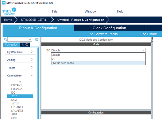

In CubeMX v6.6.1 with STM32G0 MCU package 1.6.1, there is no option for I2C2 to select SMBus-two-wire interface. Only I2C and SMBus-Alert-Mode.
Is this by design (then why?) or an error in CubeMX?

Hi Peter,
The issue here is that it is not possible to select SMBus two-wire for I2C2 from CubeMX. Only SMBus-Alert-Mode is available so it doesn't seem optional.
I don't see anything in the reference manual that states I2C2 cannot operate in two-wire mode.
My implementation does not use SMBA and the pin is allocated as a GPIO.
BTW figure 284 in section 32.4.12 is a copy/paste of figure 283 and still refers to I2C1 in it.

Well, as I wrote, SMBus is per definitionem a two-wire bus, there is no need to choose this. The only limitation is the permanently assigned pin SMBA, which is lost as a GPIO if you do not use SMBA, but can be placed on alternative GPIO positions. [see additional comment below]
The alert function is an optionally available function on the SMBus, with which the subordinate bus participants can inform the master about events. Alert has been added to the original definition of the SMBus module and can be used completely as required, i.e. with or without alert.

I must correct my statement above - the GPIO to which CubeMX has assigned the SMBA function can very well be used as a GPIO (RM0444, 32.4.12):
SMBus alert
The SMBus ALERT optional signal is supported. [...]
If the SMBus ALERT pin is not needed, the SMBA pin can be used as a standard GPIO if ALERTEN=0.
