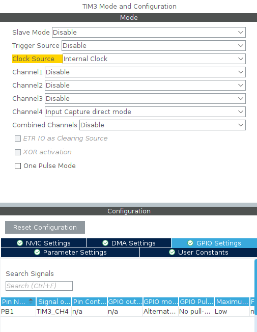

2022-09-26 10:59 AM
Hi AScha.3
Thanks for checking CubeMX, it looks like I needed to put PINB_1 into AF2_TIM3_CH4 before the other UI would recognize and use PB1.

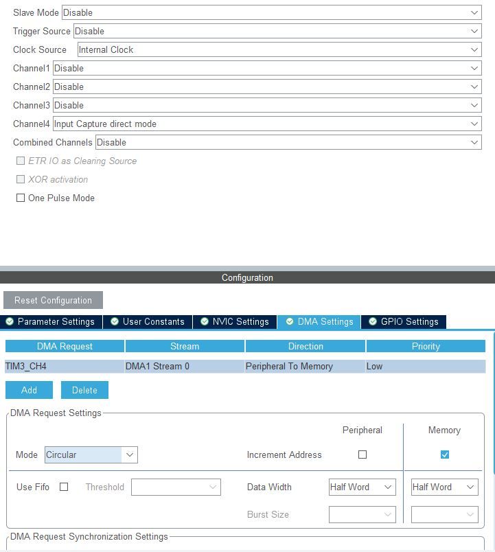

Regarding your question about the trigger, I'm actually unsure what it is triggering on currently, the mux seems to be setup for CH4 output (code below). What I want it to trigger on is: both edges of the signal on PB1 input capture (the input signal is about 1Mhz). So on both edges I want the DMA to capture the (tim3) counter value and write it into a buffer in sram, while incrementing the offset.

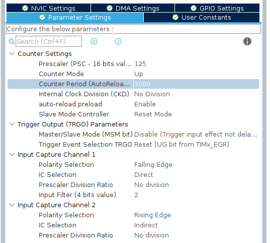

Well, should be possible . :) but is not easy, to adjust complex timer to this...
how many data you want to collect ? at frequency xx ? because at us range it will be many data in short time...
or write DMA to circular buffer ?
just: what you want to do with this ?
i made an IR receiver , decoding the IR remote signal, with interrupt after every full pulse;
about this way (just on CH 3+4) it should work:
and settting Counter Period to a max-limit lenght , what pulse never should reach.
-- maybe this setting works for you; Trigger is set in" Trigger Source" : TIxFPy

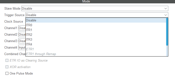

Do I need slave mode?
TIxFPy seem to all need a second IO pin which I do not have. Is there any way around this?
2022-09-28 10:07 AM

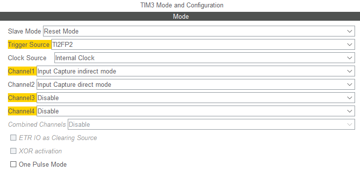

ok, so YOU take CH3/4 for capture , just i took CH1/2 because only this free pins - to show you, how to.
+ yes, slave mode -> then set Trigger source ; so it only starts timer on trigger (here from the pin -> TI_FP_ ). other wise timer runs always, what we obviously do not want here.
+ look, what i select exactly! direct/indirect mode...combination, so you get hi-time in a capture and lo-time in other channel of one complete pulse on one input pin !
+ set clock/divider to useful value, maybe 100MHz , so you get 400 at 4us pulse and counter period 500, so timer ends capture on any wrong pulse after 5us.
see my setting , also rising/falling edge selection...

This was all I needed actually. (AScha.3 first comment)
Most important things I missed was the Clock Source needing to be set to "Internal Clock" and PB1 being initialized to TIM3_CH4.
Additionally, I goofed on the PB1 pin setup internally, and set it to GPIO_MODE_INPUT instead of GPIO_MODE_AF_OD which took me for a loop.
The suggested trigger source was unnecessary for my application as that only starts the timer, in my case TI1/2_FP1/2 could not be used as it needed an additional GPIO input.
For me having the timer free-running is not an issue as long as both edges on IC CH4 trigger a DMA transfer from CCR4 to a circular buffer. I can calculate the delta between the captures in my code.
