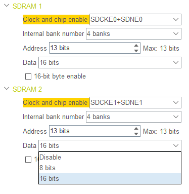

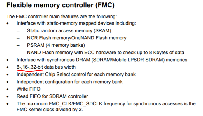

I'm trying to connect SDRAM to STM32 for the first time and I'm having trouble understanding the specs.
In the datasheet, it seems the FMC peripheral can support 32bit memory.
But when I use the Cube MX setting, I'm only able to select 16 bits for the Data.
Is there something that I'm missing in the data sheet?

If CubeMX does not allow you to select 32-bit data width, it normally means that package size doesn't support it. Which exact MCU part number did you take?

The MCU I'm using is STM32H743ZI and the FMC info pic is from the datasheet.
From your comment, I'm getting a feeling that the LQFP144 package doesn't support 32bit. I will look into it more.
2020-03-13 12:33 AM
You are right, LQFP144 does not support 32-bit data bus.
