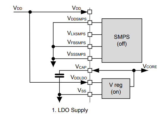

I have designed my own board with a STM32H7 MCU and set the "System supply configuration" to "1. LDO Supply selected" (see picture).
In the STM32CubeIDE in the IOC file under the item System Core - RCC the SupplySource is set to PWR_LDO_SUPPLY.

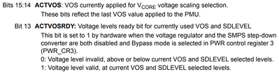

in an infinite loop, because the PWR_FLAG_ACTVOSRDY flag is apparently not set.
/* Wait till voltage level flag is set */
while (__HAL_PWR_GET_FLAG (PWR_FLAG_ACTVOSRDY) == 0U)
if ((HAL_GetTick () - tickstart) > PWR_FLAG_SETTING_DELAY)
return HAL_ERROR;

Could you explain the usage of PWR_FLAG_ACTVOSRDY?
Would you try as follows:
while (__HAL_PWR_GET_FLAG (PWR_FLAG_VOSRDY) == 0U)
Hope this helps!

I use only 3V3 on the board for the VDD pins of the MCU and for the VDDLDO pins.
VDDA is via ferrite bead on 3V3 net and the VREF+ there is still a resistor to the VDDA, so also everything on 3V3.
In the STM32CubeIDE I use an empty project with an "empty" IOC file and then I generate a code from the IOC file where the above mentioned error occurs.
Thanks and best regards Thomas
