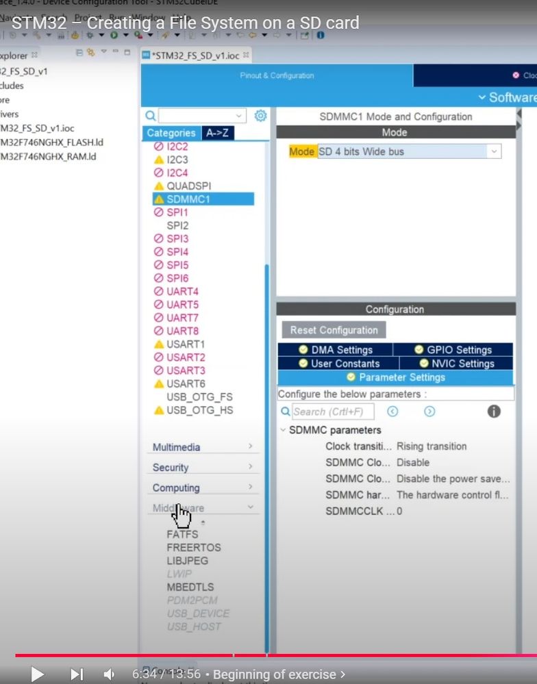

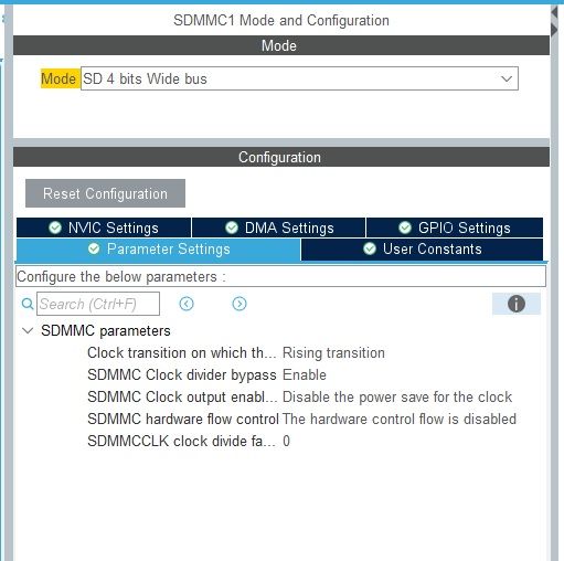

In this movie setup done SDMMC 4BIT mode selected in CubeMX:

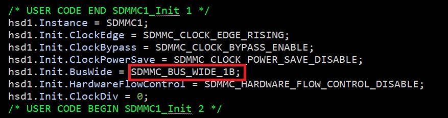

In the older versions CubeMX like video before generated code for SDMMC or SDIO 4BIT setup looks like:
That was confusing and doesn't really running SDIO/SDMMC in 4 bit wide mode.

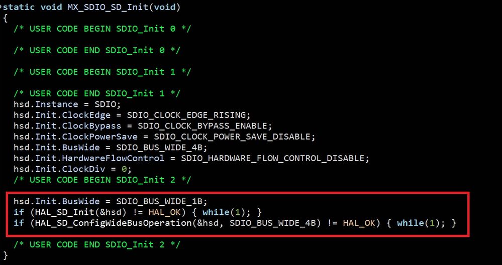

Today Cube generate code with SDMMC_BUS_WIDE_4B parameter BUT this is NOT ENOUGHT to running SDIO/SDMMC in 4 bits wide mode. Here is need a bit magic in a few codelines.

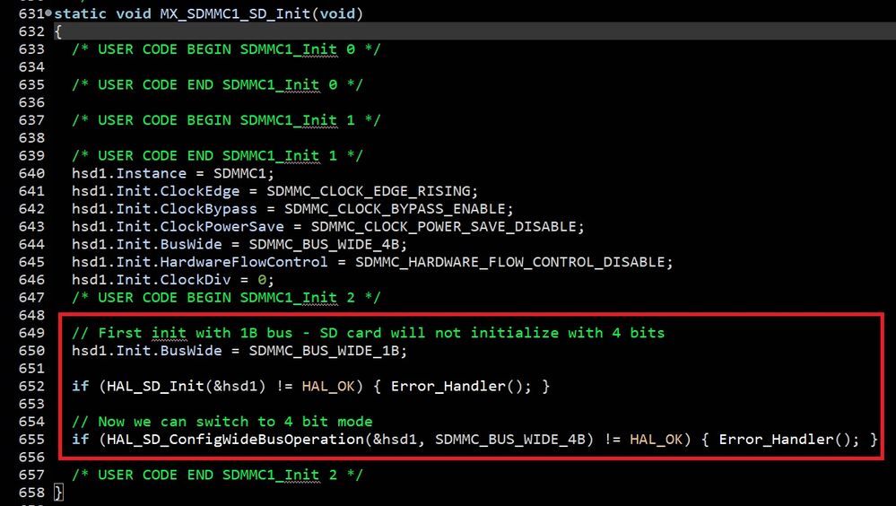

For setup DISCOVERY F746G:
In the generated code need to add a magic few lines which was selected in the red border:
In the comparision 4bit to 1bit mode was 128ms/510KB read time for 1 bit mode versus 68ms for 4 bit mode.

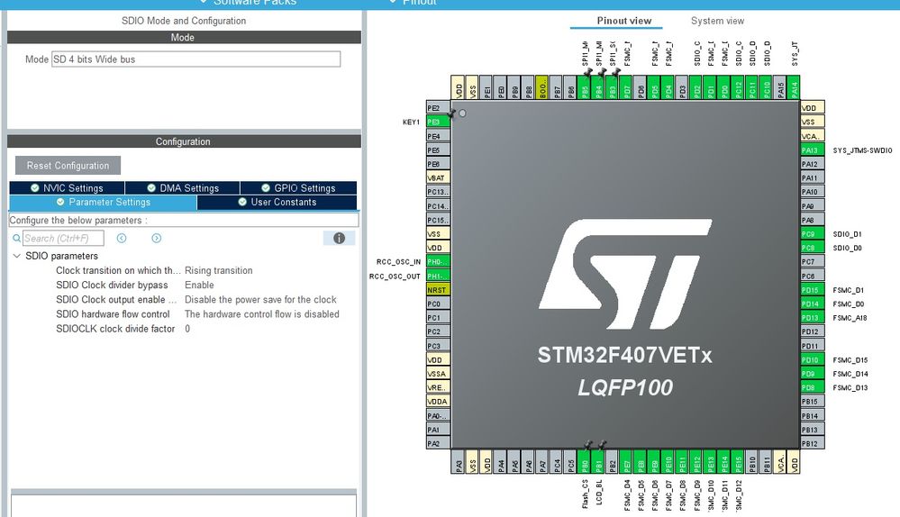

For any custom board with STM32F407VET6 was setup:
The code was very simmilary to previous:

Hello @wegi01 and thank you for the sharing.
MX_SDIO_SD_Init() should be generated with hsd.Init.BusWide = SDIO_BUS_WIDE_1B in both cases we choose SDIO Mode option
"SD 4 bits Wide bus" or "SD 1 bit".
Therefore, SDIO_BUS_WIDE_4B needs to be set at the right step : HAL_SD_ConfigWideBusOperation().
In case "SD 4 bits Wide bus" is chosen, the generated MX_SDIO_SD_Init() should follow below steps :
Step 1 - hsd.Init.BusWide set to SDIO_BUS_WIDE_1B just for initialization.
Step 2 - Call HAL_SD_Init(&hsd)
Step 3 - Call HAL_SD_ConfigWideBusOperation(&hsd, SDIO_BUS_WIDE_4B)

for STM32F407VET6
static void MX_SDIO_SD_Init(void)
{// for F407VET6 SDIO init 4bit mode generated fro STM32CubeIDE 1.17.0
/* USER CODE END SDIO_Init 1 */
hsd.Instance = SDIO;
hsd.Init.ClockEdge = SDIO_CLOCK_EDGE_RISING;
hsd.Init.ClockBypass = SDIO_CLOCK_BYPASS_ENABLE;
hsd.Init.ClockPowerSave = SDIO_CLOCK_POWER_SAVE_DISABLE;
hsd.Init.BusWide = SDIO_BUS_WIDE_4B; //!!!!!!!!!!!!!!!!!!!!!!!
hsd.Init.HardwareFlowControl = SDIO_HARDWARE_FLOW_CONTROL_DISABLE;
hsd.Init.ClockDiv = 0;
/* USER CODE BEGIN SDIO_Init 2 */
For STM32F746G DISCO
static void MX_SDMMC1_SD_Init(void)
{ // for F746G DISCO SDIO init 4bit mode generated fro STM32CubeIDE 1.17.0
/* USER CODE END SDMMC1_Init 1 */
hsd1.Instance = SDMMC1;
hsd1.Init.ClockEdge = SDMMC_CLOCK_EDGE_RISING;
hsd1.Init.ClockBypass = SDMMC_CLOCK_BYPASS_ENABLE;
hsd1.Init.ClockPowerSave = SDMMC_CLOCK_POWER_SAVE_DISABLE;
hsd1.Init.BusWide = SDMMC_BUS_WIDE_4B; //!!!!!!!!!!!!!!!!!!!!!!!!!
hsd1.Init.HardwareFlowControl = SDMMC_HARDWARE_FLOW_CONTROL_DISABLE;
hsd1.Init.ClockDiv = 0;
/* USER CODE BEGIN SDMMC1_Init 2 */
All examples got setup 4bit parameter SDIO_BUS_WIDE_4B in the initialization code, and not any one generated example doesn't include somethink like that:
hsd.Init.BusWide = SDIO_BUS_WIDE_1B;
if (HAL_SD_Init(&hsd) != HAL_OK) { while(1); }
if (HAL_SD_ConfigWideBusOperation(&hsd, SDIO_BUS_WIDE_4B) != HAL_OK) { while(1); }
/* USER CODE END SDIO_Init 2 */So withot this SDIO interface and program which invoke SDIO/SDMMC simply HANGS.
