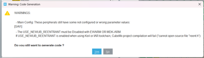

I just upgraded from version 6.13 to 6.14. I have an exiting project for an STM32H7B3 that uses SAI1. When I click the Generate Code button, I get the following warning:
(The second warning is also a bug, I'm using CMake on my project so it is irrelevant).

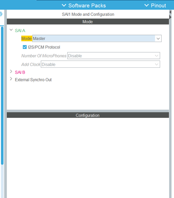

The SAI1 configuration area is also blank and does not show any warnings or errors:

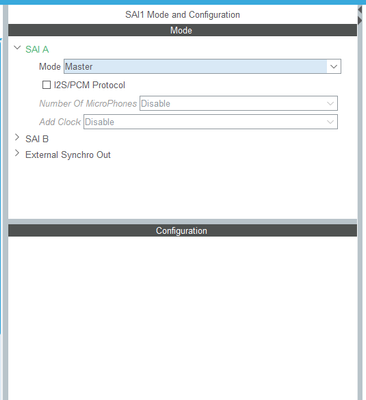

If I create a new project for the STM32H7B3LIH6Q, and enable SAI1 SAI A in master mode, my mouse just spins forever and I do not get configuration options.

Hello @cvanbeek
The issue is fixed in the latest release of the STM32CubeMX (6.14.1).
KR,
Semer.

Hello @cvanbeek
Thank you for bringing this issue to our attention.
I will internally check this issue and get back to you as soon as possible.
BR,
Souhaib
2025-03-07 2:22 AM
Hello @cvanbeek
Issue confirmed and raised to the relevant team for fix.
Internal ticket number: 204848 (This is an internal tracking number and is not accessible or usable by customer).
Thank you,
Souhaib
2025-05-20 7:00 AM
Hello @cvanbeek
KR,
Semer.
