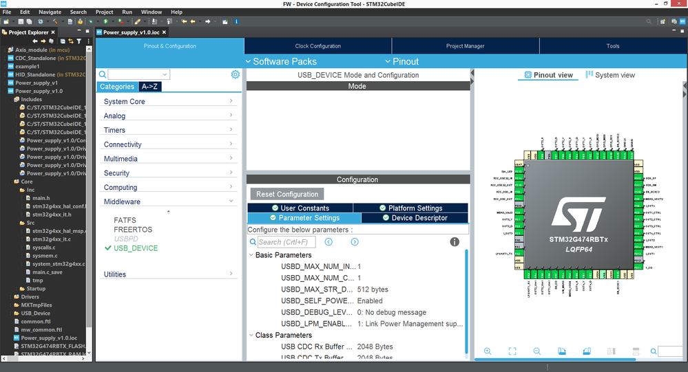

I am running into some problems with generating new code for my MCU (STM32G474RBT6).
I have installed STM32CubeIDE v1.6.0 and FW pack v1.4.0.
I have created my entire pinout with a correct setup (my friend checked it and he is working with these MCUs on profesional level)
Problem is that code does not contain parts for USB CDC.
Everything is generated correctly but there are no:
usb_device.c
usbd_cdc_if.c
etc.
Looking forward for any help.

2021-03-27 12:12 PM
Maybe you dont select midleware usb device checkbox...
2021-03-27 12:24 PM
I am not sure what exactly do you mean. I think I got everything here.
2021-03-27 11:05 PM
BTW, on that image you can see my another problem which is happening to me almost everytime or everytime I regenerate the code. My main.c file stays with the name main.c_save. I always have to delete entire project and create new one based on my .ioc file or rename it manually. Thankfully I havent started writing most of the code yet.

Well, today I have tried it again and regenerated entire code based on .ioc file and now I have even middleware folder there.
2021-04-02 9:40 AM
Honestly I am starting to be lost. Newly generated code which finaly contains every important part is not working. A have added into it just stupid LED blinking but after powering board up nothing happens. I have tried connecting a debugger into it with this result:

I am putting here new hopefully completely generated code which should at least blink but it is doing nothing at all.
Thanks for any kind of suggestions.
It is like my IDE is generating every week something new to my project...
2021-04-04 5:00 AM
I have added here some new points. My friend is telling me that it could be caused by the fact that it is the new model of MCU and there might be some bugs in generating code in IDE. I honestly do not know. But last code which should at least act as an COM port is doing nothing at all.
