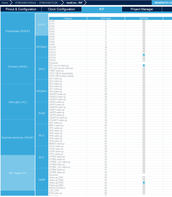

I made a test IOC file. There are 3 SECURE checkboxes checked in RIF -> RIF Aware IPs -> EXTI1:
Screenshot:
Generated SystemIsolation_Config(void) in main.c of FSBL contains:
/* set up EXTI configuration */
/* EXTI13 line */
HAL_EXTI_ConfigLineAttributes(13,EXTI_LINE_SEC|EXTI_LINE_NPRIV);
/* RTC secure wake-up line */
HAL_EXTI_ConfigLineAttributes(17,EXTI_LINE_SEC|EXTI_LINE_NPRIV);
/* Wake-up_PIN3 line */
HAL_EXTI_ConfigLineAttributes(62,EXTI_LINE_SEC|EXTI_LINE_NPRIV);These calls fail in this assert in stm32n6xx_hal_exti.c:
