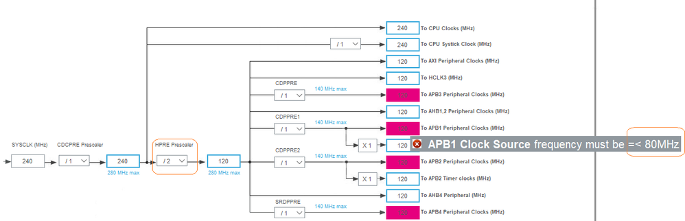

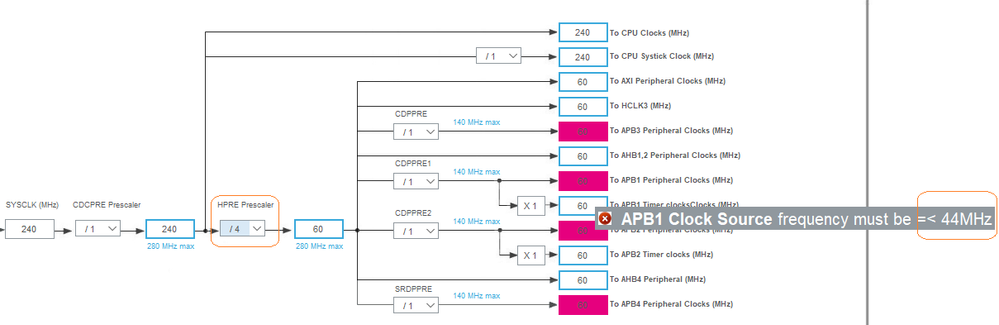

1) When changing HPRE prescaler only CubeMX unexpectedly changes timer clock limits.
I think those limits should depend on VOS voltage which, in turn, depends on SYSCLK, rather than on post-HPRE clock. As a result, lowering timers' clock lowers the max limits - see the screenshots. This does not seem to make sense.
