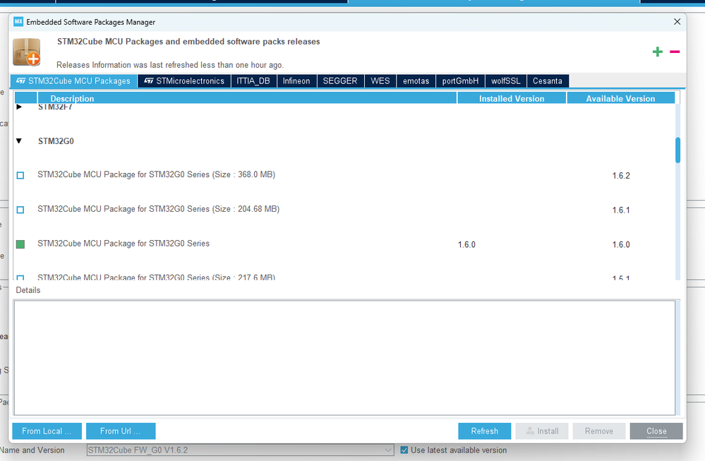

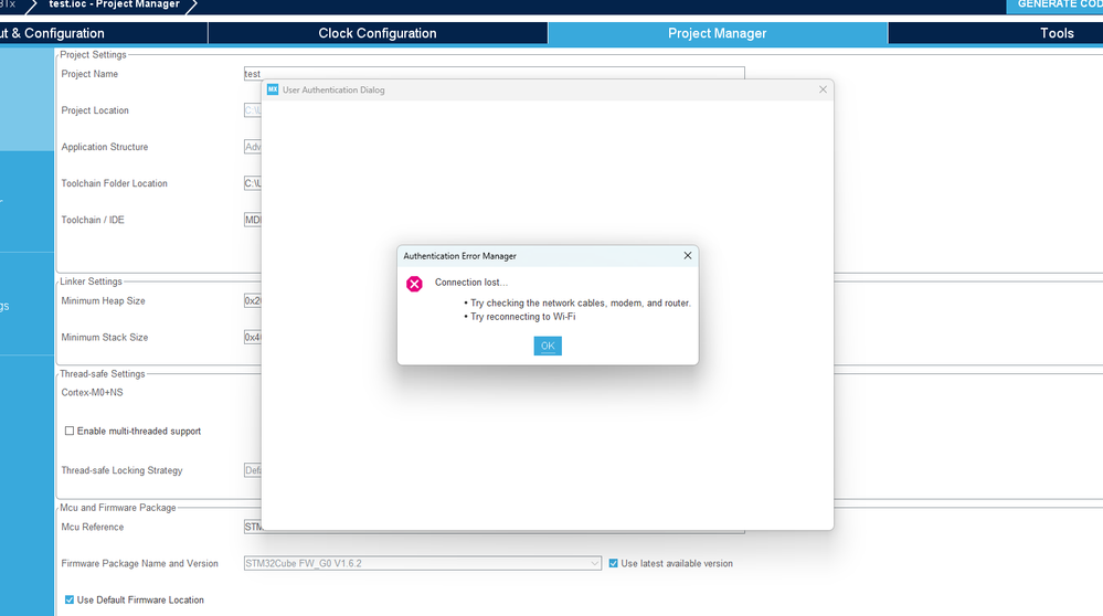

cubemx Version 6.11.1
I just want to install the G0 pack. But I cann't login even using VPN. My net works very well!

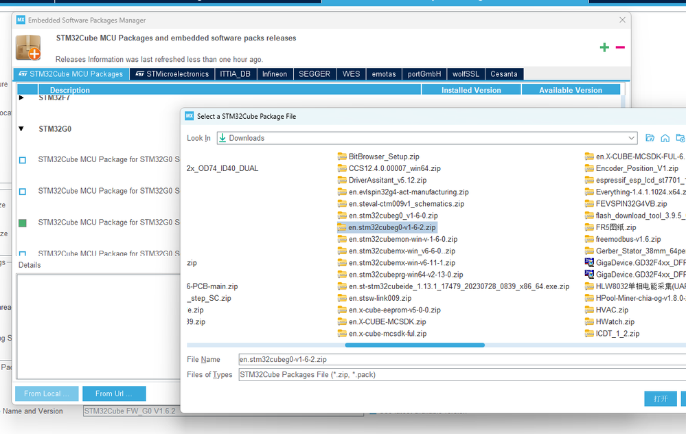

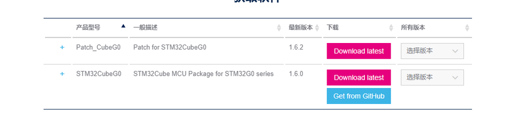

So I can only download it from the official website and then install it locally.
The STM32CubeG0 was installed successfully.

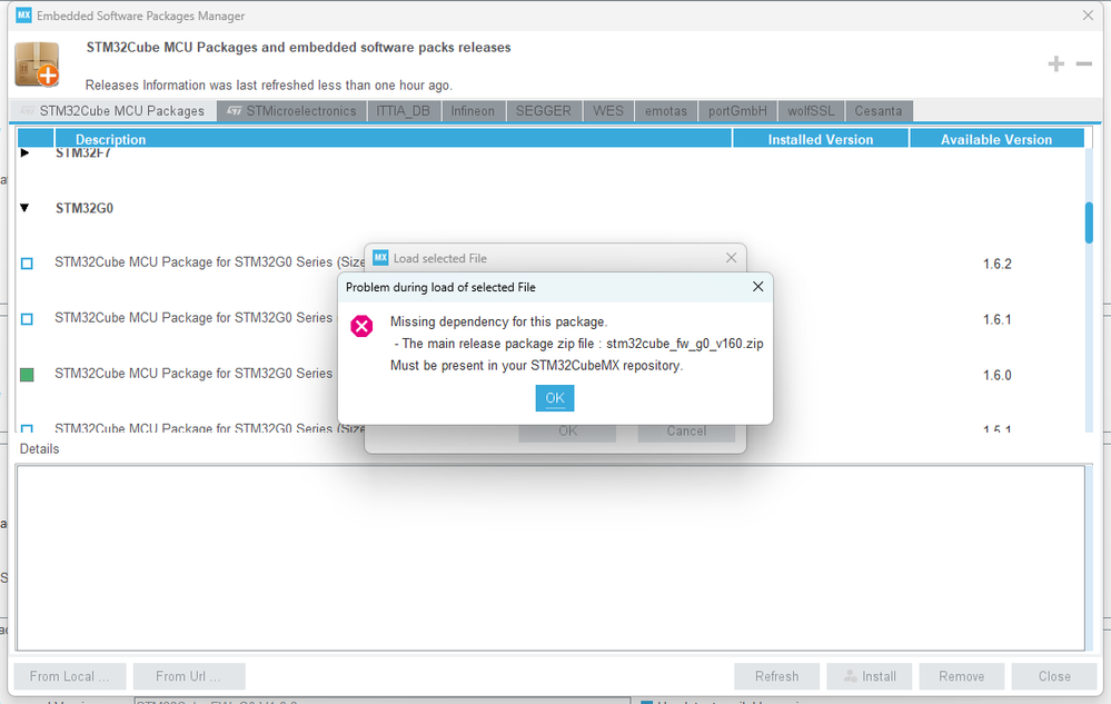

Then I want to install Patch_CubeG0.
What the ***?Are you joking?

I have solved this problem by unzipping the firmware package myself and changing its name.

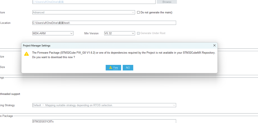

Not sure I'd be building things in a OneDrive directory, use a real one.
For the dependency, try copying the downloaded 1.6.0 ZIP into the repo directory and renaming it slightly to match the form it's looking for.

Yes, what's the deal with this "Connection Lost" business? We are getting this now in our office. Everything else on our network is fine. What is different about CubeMX that is causing it to be blocked?
