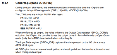

Ok, so mentioned as a PU here, looks like you're SOL

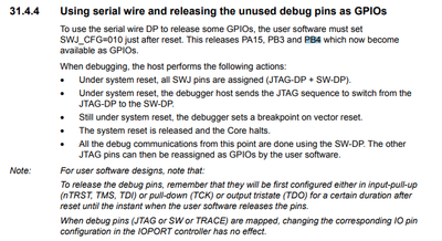

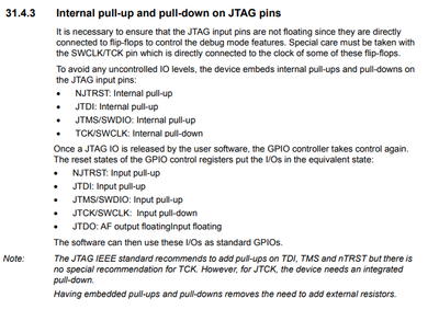

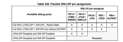

I found these in the manual
it looks like this stuff is only available after Reset:
