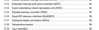

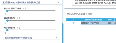

That has a QUADSPI but not OSPI that I can see.
CubeMX seems to agree.
Where in the datasheet or CubeMX do you see that it has an OCTOSPI?

Thanks for finding that, when I looked in the datasheet I had a few open and looked in the wrong one.

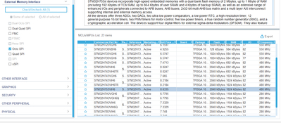

However, there might still be a bug in CubeMX. I did another search through CubeMX, and sure enough that part is showing up. Maybe the OctoSPI checkbox filter is not enough and you actually need to set the OctoSPI quantity instead. If that is the case, then maybe the checkbox is bugged.
