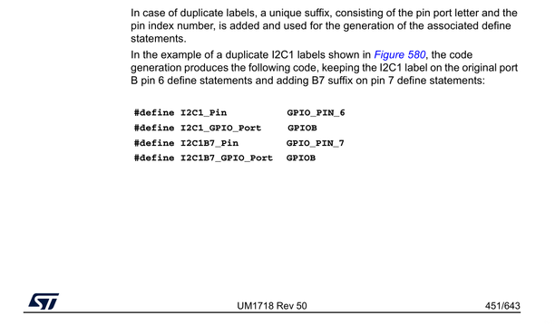

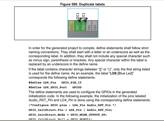

Your findings match exactly what CubeMX is documented to do, and they also explain why you saw the behavior with CLK-A / CLK_A. What the documentation says:
1- Label normalization rules:
Labels must start with a letter or _.
They must not include special characters like -, (), [], etc.
Any special character is replaced by _ in the generated #define name.
So:
CLK-A → normalized to CLK_A
CLK_A → already valid, stays CLK_A
2- Duplicate labels :If there are duplicate labels (after normalization), CubeMX
Keeps the original label as‑is for the first pin.
Adds a unique suffix <Port><Pin> for the next ones.
/* Private defines -----------------------------------------------------------*/
#define CLK_A_Pin GPIO_PIN_0
#define CLK_A_GPIO_Port GPIOF
#define CLK_AG7_Pin GPIO_PIN_7
#define CLK_AG7_GPIO_Port GPIOG
THX
Ghofrane

This is true.
But it would not forbid CubeMX to warn about duplicate sanitized names.

Yes, that would be helpful!
@Ghofrane GSOURI It's one thing to have the behaviour documented, but it would still be helpful to get a warning in the app when this happens.
