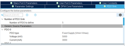

I set the Number of PDO to define = 5 in the cubeide.
But after generate code, the code in usbpd_pdo_defs.h, macro:PORT0_NB_SINKPDO is still 1U.
I also checked the file usbpd_pdo_defs_u5.ftl in cubeide's location, the macro PORT0_NB_SINKPDO is a value param from cubeide indeed, but it seems not effective. Is a bug?

Hello @Jason927 ,
I was able to reproduce your request.
Thank you for bringing this issue to our attention.
An internal Ticket was submitted to the Development Team (Internal Ticket Number: 216304).
I will keep you up to date when the problem is solved.
Thanks.
Mahmoud

Hello @Jason927 ,
Thanks.
Mahmoud
