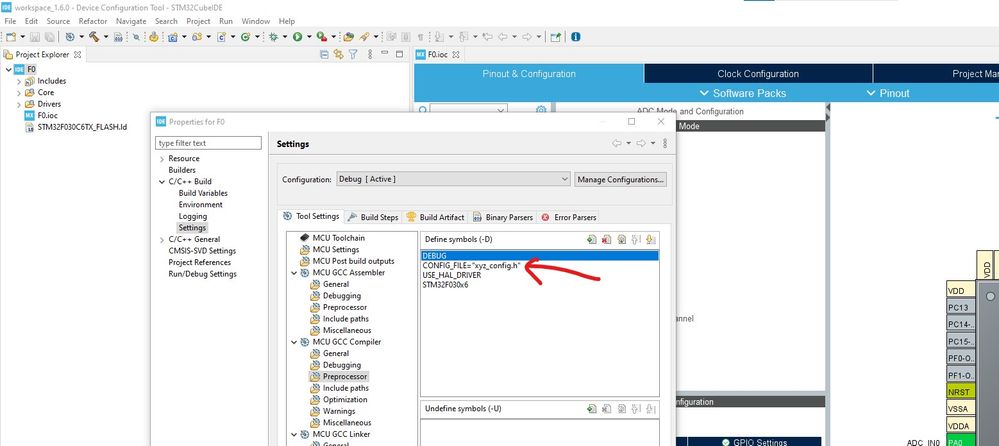

I'm working with CubeMX 6.2 & CubeIDE 1.6.0.
I have several problems with the generated code that I would like to know if I can somehow resolve instead of changing the generated code every time after changing something in the CubeMX project.
This is the list:

2021-03-29 1:03 AM
Myself if 1.6.0 I've no issue to keep my sybol definition despite asking for new code generation (because IP setup update or ...)
If expecting to prevent DMA descriptors clash I gues sonly way is to not setup such DMA as part of your device configuration activities. If no set for sure no related code will be generated
