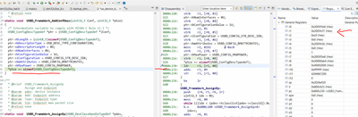

in ux_device_descriptors.c,
I see a hard fault at this highlighted line

Using default 13.3 toolchain that comes with STM32Cube IDE 1.18.0 , I see the issue at later point.
If I use local toolchain sysgcc (arm-eabi-none-*) , then I see issue at former with "-m-no-unaligned-access" and later with "-maligned-access"
2025-03-13 7:23 AM
with -mno-unaligned-access flag
