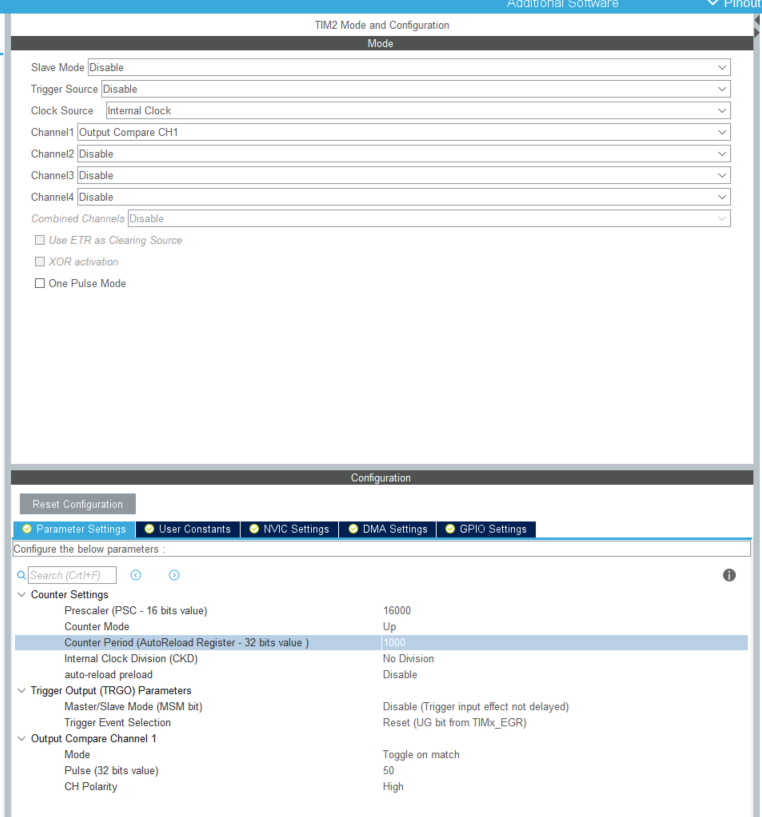

I am trying to generate pulses using output compare mode for my stepper motor on my board STM32f103C8T6 and STM32F401CCU6 on various timers. For some reason I am not able to change the period i want the signal to toggle at i.e
sConfigOC.Pulse
Here is my config:
Here is my output, it remains the same regardless of changing the pulse:
Here is my code:

2019-12-03 9:55 PM
> sConfigOC.OCMode = TIM_OCMODE_TOGGLE;
No, use one of the PWM modes.
2019-12-03 11:57 PM
my previous practice was to use the PWM mode;
by changing the ARR value and CCR = ARR(value)/2 to allow me to change the frequency. But this means that it will also affect the other channels under the same timer. Which is not very critical but trying to find a better solution for this in-case in future i have to use more channels under same timer.
