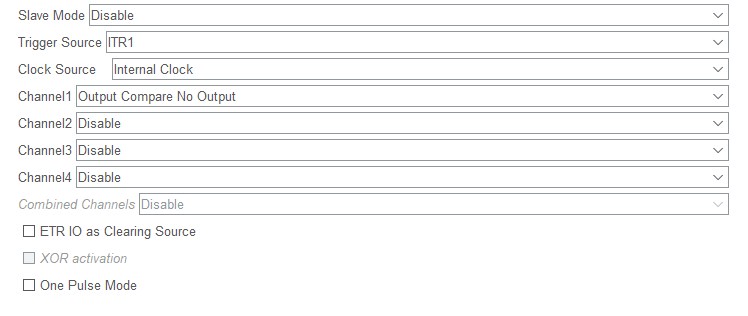

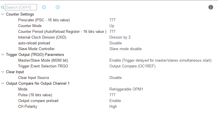

Using MX, I setup TIM3 as below.

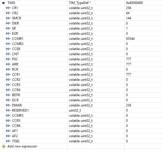

I open the live expression window and put a breakpoint in main.c - as shown below.
Then, I press the 'Resume' button repeatedly.
The code stops at my breakpoint each time.
I assume the timer is running all the time.
So, I'm expecting TIM3->CNT to have a different value each time I push the 'Resume' button.
But TIM3->CNT is always zero.

Here's what I put in the MX configuration for TIM3...

Here's TIM3 in the debugger expression window..
2019-12-02 3:24 AM
I found the problem: need to enable the timer.
This method works.
Count has a different value (almost) every time I press 'Resume'.
