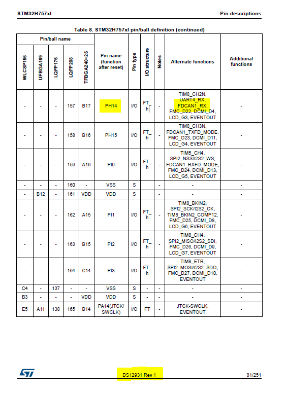

Hello @Community member ,
Could you please give me more details about your request?
"according to DS12931 Rev 1 this pin is very likely just able to work in CAN mode but not in CANFD. " : please see attached picture , PH14 (according to DS12931 Rev 1) able to work in FDCAN1_RX mode.

2019-12-02 6:48 AM
@Community member
+ DS12931 Rev 1 is DS for STM32H757xI and not stm32H747.
Best Regards,
Khouloud
