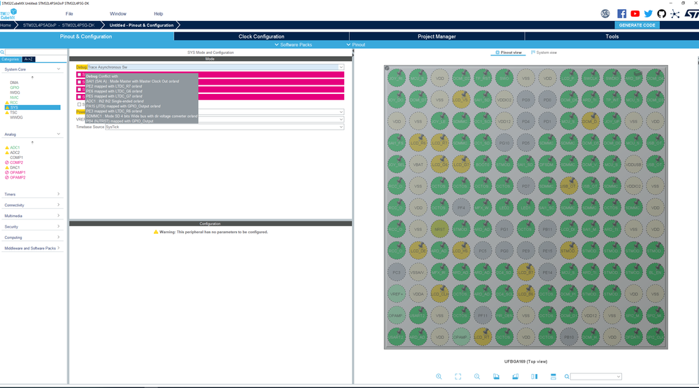

Let's try this solution:
As shown in the screenshot , we need to eliminate the conflicts in order to make the "Trace asynchronous Sw" is the SWD (serial wire), works correctly

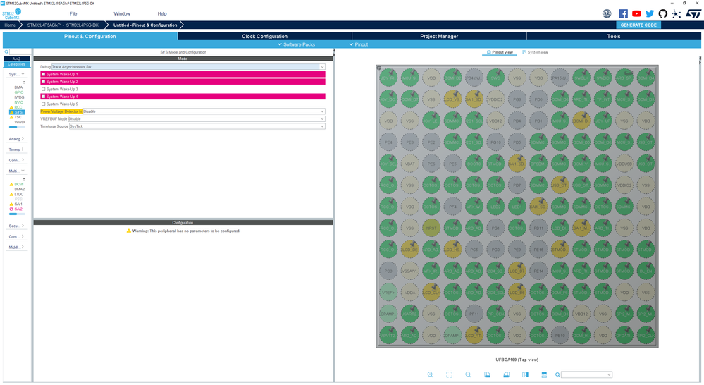

After solving the conflicts :

"Trace asynchronous Sw" is the SWD (serial wire), with additional SWO pin. So this is OK.
The red colored things are not relevant.
2023-05-08 1:49 AM
@Pavel A. I understand what you mean, however, I exported to keil via GENERATE CODE and it will not work after burning to the development board in keil.

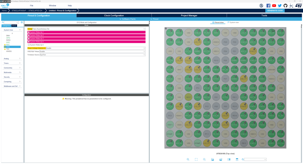

2023-05-08 4:18 AM
@Ghofrane GSOURI
Thank you very much indeed, the problem is solved!
