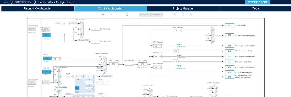

Hello @Community member ,
I couldn't reproduce this issue :
Foued
2023-05-03 2:35 AM
ok thank you for the hint, but shouldn't the "resolve" solve that?
Regards
Uwe
2023-05-03 2:40 AM
You may choose the right combination to reach 250MHz.
2023-05-08 1:44 AM
some pre-configured interfaces (import from old MCU) limit the max frequency to 200 MHz.
We are working it, but thank you for the hint.
Regards
Uwe
