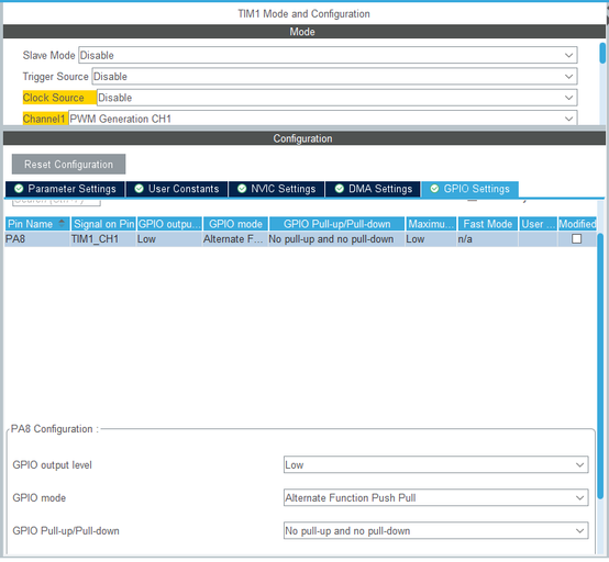

I have a STM32F469I-DISCO board. It seems that I am unable to change the GPIO Pull-up/Pull-down Mode for a timer. I have tried to do it both in the CubeMX interface, and I have also looked through the HAL methods and attributes. I don't think it's an option. Does anyone happen to know why?
2025-02-14 3:14 PM
It's at the bottom of the tab. Use the scroll bar

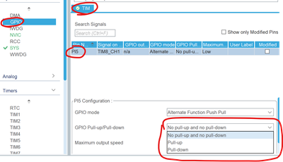

After setting the pin as a TIMx pin, you can change the pullup/pulldown in the GPIO tab on the left side.

Oh my gosh, I totally missed scrolling down to see more options! I did check the GPIO part of the CubeMX, but again, I was blind and didn't see the TIM tab. Thanks everyone for the quick, thorough responses!
