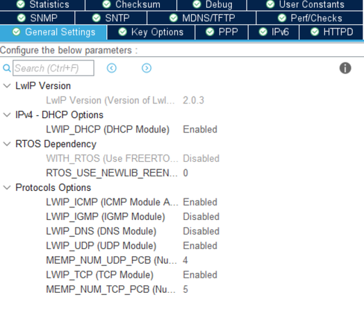

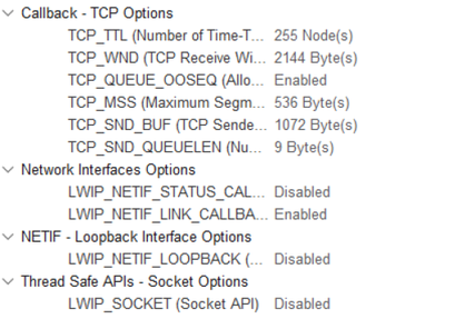

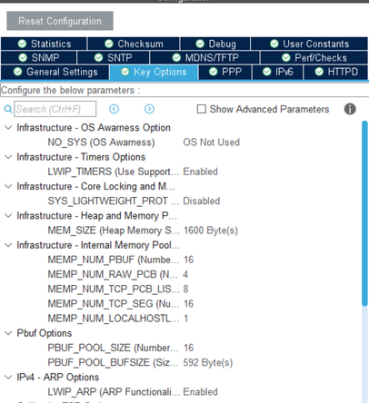

Key Option Settings
I am here because I am able to ping the board from my laptop,but not able to connect to the software Hercules(TCP Server).
I have attached my code zip and also pasted the main.c code.
