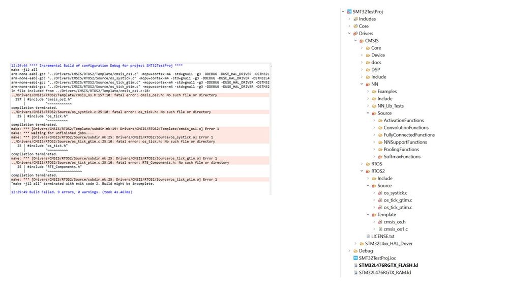

Thanks both Ghofrane GSOURI & Andrew Neil for pointers. Adopting the method shown in the presentation. I have selected a nucleo development board to create an STM32MX project. I have then created a STM32CubeIDE projecfrom the MX project. Having not written any code yet, I'm getting compilation errors but have no idea why? The errors are relating to files marked with a red x below:

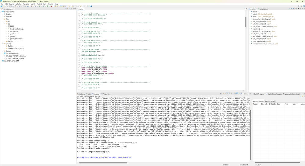

Hello @GChol.1
I have just run a test using your IOC file, and the project builds successfully, as shown in the screenshot below.
Please try the following on your side:
1- Move your IOC file to a new, empty folder.
2- Open this IOC file in STM32CubeMX.
3- Generate the code for your IDE from STM32CubeMX.
5- Open the generated project in the IDE and rebuild it.
THX
Ghofrane

2026-03-06 5:07 AM
CubeMX V6.17.0. I have also tried with CubeIDE V2.0.0 and V2.1.0

Hello @GChol.1
THX
Ghofrane
2026-03-11 5:27 AM
@Ghofrane GSOURI Many thanks, suggestions worked!
