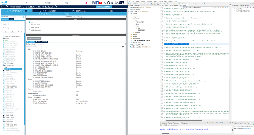

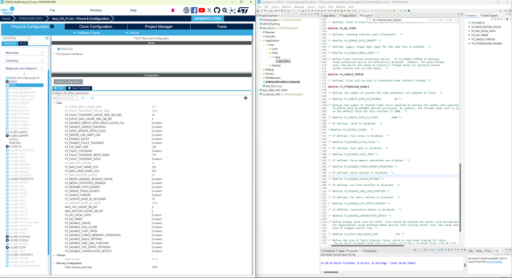

I'm trying to access SD cards with an STM32C091 MCU. It seems like FatFS is not supported by default in CubeMX, therefore I looked into FileX. I don't have a need for running an RTOS, so I would like to run FileX in standalone mode. However, the FileX parameters in CubeMX don't contain FX_STANDALONE_ENABLE (see attached). Can anyone offer some insight into the topic?

Hello @biebert
When you enable FileX in standalone mode (without enabling ThreadX) and generate the code in STM32CubeMX, the FX_STANDALONE_ENABLE macro is automatically set.
You can verify this by opening the generated fx_user.h file, where you will find FX_STANDALONE_ENABLE defined, as shown below.
When both FileX and ThreadX are enabled in STM32CubeMX, the project is generated in RTOS mode.
In this case, the FX_STANDALONE_ENABLE macro is commented out (or not defined) in the generated fx_user.h file
However , a change request #0060443 has been escalated to dev team to expose FileX standalone mode more clearly in STM32CubeMX (FX_STANDALONE_ENABLE) .
