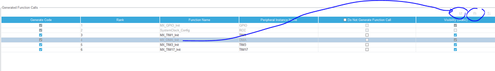

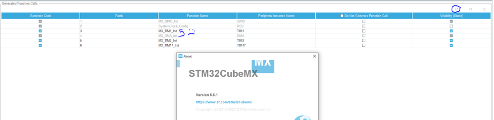

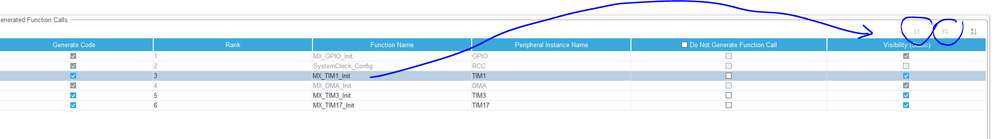

@Sara BEN HADJ YAHYA I got the same issue with cubeMx 6.6.1
I cannot change the order , for some reason DMa is greyed out and TIM1 cannot be moved neither
For the others TIM3 and TIM17 , i am able to change positions

Not for me, aparently if you migrated the cubeMX from older versions DMA's place in the Advanced Settings menu cannot be changed

I do the same, to manually override initialization of the DMA, but every time i click autogenerate it tends to switch them back to the wrong order, it gets very tyring after a while.
